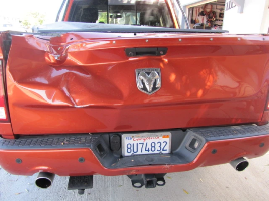

I had to rent a trailer to tow my daughters car. I screwed up and didn't triple check the connection and when she started to drive on, the trailer came off and gouged the tailgate. I bought the insurance only to find out when they denied my claim. that the vehicle doing the towing is not covered if damaged by their equipment. I am livid to say the least! All three body shops say new tailgate. Time to start looking for a good used one or pay out about $2500 when all is said and done. I doubt if Progressive is gonna cover it, but they will get a call.

Any good body shop could straighten it out.
They would pull the tailgate inspection cover to get to it
check the price for that, against a good used tailgate & getting it painted.
Either way, the Tailgate comes off very easily, so you can continue to drive your Ram.

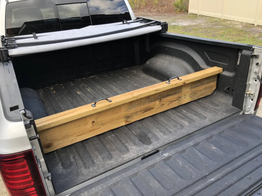

IF you need to haul something, all pickup trucks of every brand, makes slots for 2 by 6s or 2 by 8s

Insurance will probably want to replace with one that is aftermarket, which can be okay but my experience it gets you one that may not fit exactly correctly in all gaps, or metal may not be fully framed properly to prevent future damage if you go through insurance go to a Ram dealer for repair, they may be able to get you a new OEM for near cost of aftermarket. Also, they will first try to find one that is LKQ, which is Like Kind and Quality and is a used one that is generally rated A0, no damage. This could be a great way to save money and get OEM. In fact, search www.car-parts.com and you may find one that even matches color already of a front damage truck.
I believe you can use up to a 2018 tailgate plus 2019 up classic. Either 1500 or 2500 but check with recycler to see if it is a fit. Even if different color you can get a pretty close match in painting it and with minimal fender surface area on other side of gap it shouldn't really show if tone is off. The sticker is tricky, you may be able to order or take tailgate to a vinyl sign maker and they may be able to create one. This could save your experience rating with insurance and not break the bank

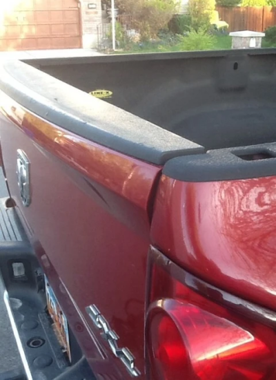

mentioned that the tailgate widths have been the same for 3rd, 4th,& 5th gen rams
4th Gen Tailgate on a 3rd Gen Dodge Ram
4th Gen Rams have a water catcher, at the top of the tailgate, but it is only the Plastic Cap
4th Gen without the cap
5th Gens have a Flat top
I have NOT been able to find the actual measurement of the TOTAL Height of the 5th Gen Ram Tailgate
They only give the Bed Depth for the DT Rams
They changed the Tailgate Hinge Point Types on the DTs
ie: Male & Female pivot points

As mentioned above, one option would be to find a factory tailgate of the same color in a junkyard. You could then have the Power Wagon sticker applied to it (if you can find it). Doing a real quick search on Google looks like you could get one for $300-$500 and slap it on yourself.

Two things, that should not need a new tailgate to fix. I would find a better body shop. Second, UHaul is so notoriously bad that there are a few law firms in the States that make all or a lot of their income from suing just UHaul. You can also go after them in small claims court. According to your account, their defective equipment damaged your vehicle, whatever their insurance form says is irrelevant.
