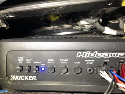

Got the Kicker installed last night. Fits under the passenger seat pretty good actually. Jack stand is under the back seat (previous owner put it there). The Kicker won’t fit under the back seat laying flat on floor. When the seat comes down from being folded up the amp is too high. It does fit under the drivers seat, but with the heated and cooled seats (which I have) it’s a bit tighter, but doable. On drivers side a person would want to bend the bracket for the seat harness connectors ever so slightly for peace of mind. I only did the passenger side since the original owner had already removed the jack. I took one Kicker bracket & cut it in half and as seen in picture connected to another. I used a brass bushing about 3/8” high to level the right side of the Kicker sub. Can’t see it as it’s below the carpeting. Left side of Kicker I used a the other factory hole I presume was there for the jack.

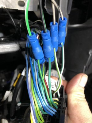

Here’s a few pics of the connections behind the radio & the center console port that I tapped for 12v remote turn on. Hope helps others wondering where and what to connect to. I tapped the left & right rear speakers from behind the radio. The kicker harness had plenty of length for speaker high level inputs as well as the 12v power to the battery. The remote turn on (blue wire) was not long enough. Only came with 2’ of cable or so. Ground was just as short. I used Posi-Taps for connections on speaker wires & remote turn on at 12v source. Soldered the connections for the main fuse under the hood & for the remote turn on wire to make it longer. Bought the Posi-Taps off of Amazon. Like $10 for 6 of them lol, but worth it. The speaker wires off the Posi-Taps are wires I had laying around. I had a brain fart and forgot the harness had plenty of length LOL. I ran the Kicker speaker wires up to the taps and removed mine (not seen in pics).

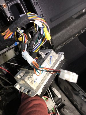

Random behind head unit pics. Nothing special.
