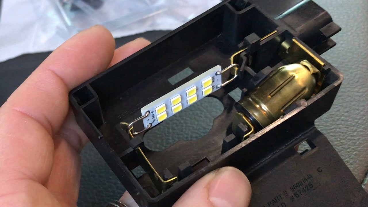

Installed the under hood light with the factory harness and
aftermarket LED light. Now the light won't go out when I shut
the hood. So where is switch, is it in the light or could it be
computer controlled?
Please help inform me before I buy a mercury switch. TIA

If you used the OEM light kit the switch is a mercury switch built into the unit.

Pop the original bulb back in,and see if it works properly.Only throwing this out there,but do you have it mounted so the pigtail faces up when the hood is open.It's virtually impossible to mount it wrong,but i did run into 1 guy who beat the virtually impossible odds and managed to mount his wrong,lol

I bought the whole led light on ebay, housing and all.
Couldn't get it to work no matter which way I turned it!
Well I'm a glutton for punishment, ordered another.
Let you know how it goes.

Post a picture of what you bought,or a link to the light. I'm starting to think you don't have the factory mercury switch equipped under hood light,if that's the case,you'll have to add your own switch to it.

I got a new LED light from eBay and works great , I pointed the electrical connection up and works great. Thanks much for all the input

Except the "switch" is audibly not a mercury switch. And the bulb is some stupid kind that is hard to find a "better known" brand of to replace. Helps a lot even with the crappy incandescent though!
