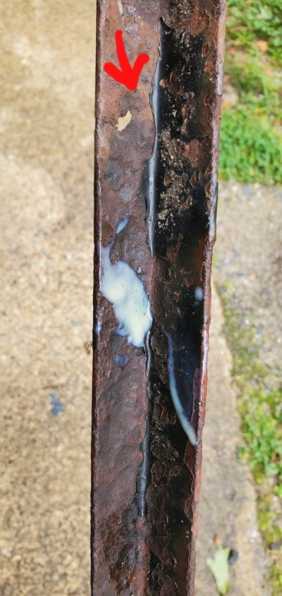

I dabbed a bit of Fluid Film and Woolwax on a rusty piece of angle iron.
FF seems to creep slightly better but WW definitely does creep very well. The arrow shows where WW creeps to after 3 weeks. FF is on the left and it's creeper up slightly further. Think I'm going with WW going forward because it resists washaway better than FF.
