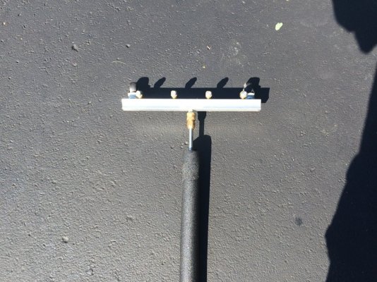

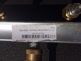

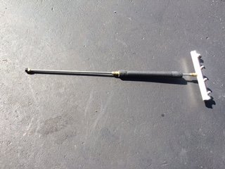

I've posted this before. Well worth the investment to wash your undercarriage after the salt is off of the roads or before touching up your spray coatings. The 4 nozzle head can be purchased off of Amazon. I went to Lowes for the extensions to match my pressure washer. The pipe insulation was added so I don't scratch my sills.

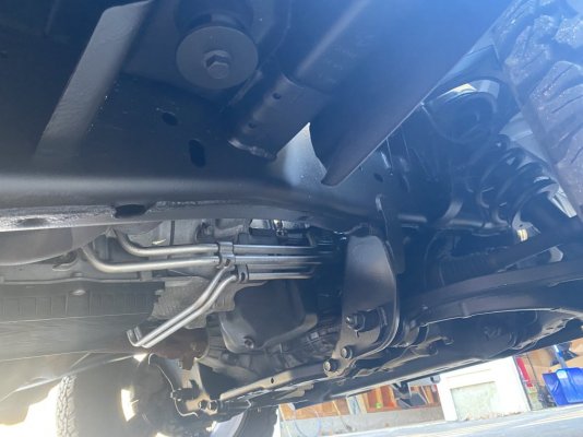

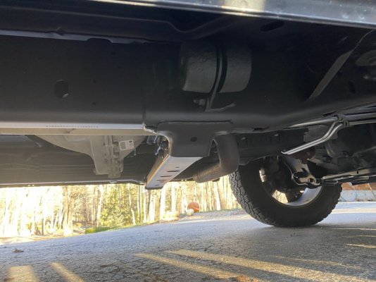

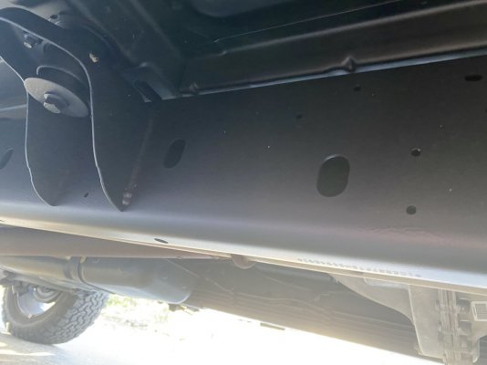

Had my truck undercoated with Waxoyl over the weekend. First impression is that I’m very impressed. Looks fantastic!
Wasn’t cheap (right at $1,000) but its lifetime touchups regardless of size for $50. Pics below… pretty noticeable difference.

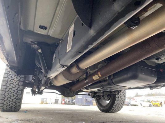

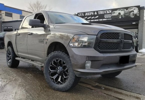

I’m in Ontario Canada where they use road salt and brine, and I got my 21’ Classic in early March 2021 the day after it arrived on the lot at the dealer from the plant, took delivery of it on a Thursday evening and the next day I had the tires switched to Toyo Open Country AT3’s and then it went straight to the Krown shop up the street from my work to be undercoated. A guy I work with has a Tacoma that is probably 7-10 years old now and he gets it done at Krown annually, and the underneath etc. is still like new, easy to work on, nothing is rusted solid or seized. So I decided I’d try it also, it’s not crazy expensive, and I even got a free can of Krown spray that I used to go over spots that I wanted to make sure got coated, like inside the hitch receiver, suspension parts, bolts, running boards and anything that looked like it wasn’t coated as much as I’d like, and I plan on bringing it back each year to be recoated.
I only have one truck, got it brand new and I intend to keep it running well and looking great for as long as possible. Rams tend to rust out around the fenders especially, so I’ll also spray extra in there even after it’s done by Krown.
So far so good, coming up on 10 months now and no major rust spots, under the frame and suspension still looks great. I have new 14” wide kick back mud flaps coming to help with the crud being slung up the sides of the truck as I recently had a 4” lift put on the truck with 20x9 +1 wheels and 35” 12.50 Toyo tires so there’s a noticeable amount of snow/dirt/salt being flung up the sides and running boards as a result of the slightly more aggressive wheel poke out of the fenders, so the mats should help with that along with the Krown spraying.
