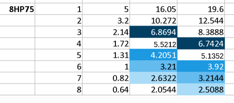

Lets do the math. A 3.21 in 6th gear has a gear ratio of 3.21. A 3.92 in 7th has a 3.2144 gear ratio.
Fact #1: When the 3.21 is in 6th gear, the engine RPMs and mph will be identical to the 3.92 in 7th gear.
Fact #2 Since the engine RPMs are the same, and the mph are the same, so is the torque/power.
Please point out which of those 2 facts you don't accept as true.

Not to get in the middle of a ******* contest, but you are correct.
Torque multiplication can happen in the rear end or in the transmission, really makes no difference where
With the old 3 and 4 speed autos there was much bigger ratio gap in the trans between gears and lower rear end gears helped.
With these 8 speeds, there are plenty of transmission ratios to let the engine rev to where it needs to when towing.
