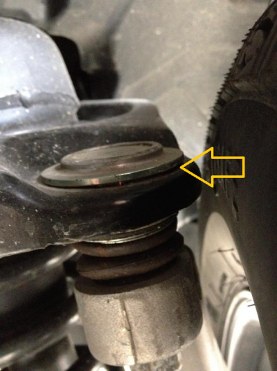

Assuming your truck is 4wd (because I don't know as much about the 2wd front suspension) - this is pretty easy for you to inspect, or even just take a photo to get a few internet eyes on it.
Your truck has upper and lower control arms that connect the front wheels to the chassis. The upper one is stamped steel and has a ball joint pressed into it just by friction/interference fit, in other words the only thing holding it in there is the hole is the same size as the body of the joint and they smashed it in there really tight.
Particularly on trucks that have been leveled or lifted, but also apparently just on regular trucks that spend a bit of time on bumpy roads the ball joint can loosen over time, make noise and eventually could fail catastrophically.
Here is a photo of one that's becoming loose:
Just check visually if there's a little gap there, both sides of the truck. Shouldn't be too difficult, you may have to turn the steering wheel to see in there without getting down on the ground.
That would be the first place I'd inspect for front end knocking.
