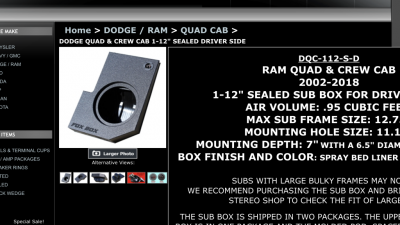

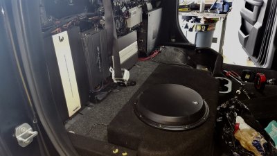

As Cableman said, Net Audio is probably the best quality prefab box you can get. I have the Passenger Side Tall box with a JL 12W6V3 and it will rattle your spine while giving you extremely high SQ.
A lot of cheaper subs are designed to get loud at the low end while playing Rap and other electronic music with synthesized bass. When you get into things like Rock with fast kick drums or something like Jazz with a fast standup Bass line or even R&B with intricate bass, the cheap subs can start to fall apart sonically and blend the notes together.
Here’s a bad photo of my setup. I really need to take better pictures...

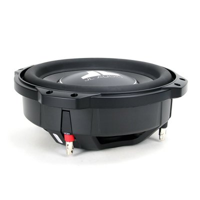

I’ll help you with your decision by saying if the subwoofer is over 5.75” in top mount depth you’re going to lose your back seat(s). You can shim the subs up to gain clearance on the back of the enclosure but the seats also have to follow to fold down and clear.

When you start getting into pancake or shallow subs with huge diameter 6”+ motor assemblies, it creates another interference because of the taper in the floor pockets and you only have a few inches of depth.
Had to end mill a couple 1/4” deep blind holes in the bottom of the box before the taper to clear the terminals in my application.

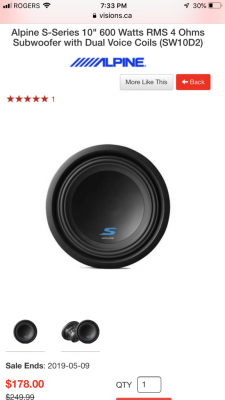

The 10” speaker shown above was just dropped more in price. I think I’m going to snag one... the 12” version is also a good price but is dual 2ohm which I was told to avoid.

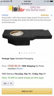

Has anyone used the Atrend single 10 sealed box?
It has plenty of mounting depth, the right amount of air volume for the sub, and is cheap :)

Prolly lose some mounting depth with that box being mdf on the bottom, but if it fits im sure it will sound great for what your looking for.

This is the best I can do up here and it’s a 10. A 10 would suit me fine though:
If your Amp is 1ohm stable get the dual 2ohm voice coil subs, if 2 ohm stable get the dual 4ohm ones. I bought 2, Infinity kappa 1200w subs today, $106 each shipped. If they don't work in the Rams box, will put them in my Camaro.
