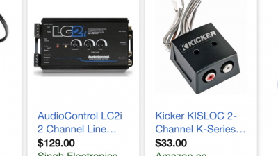

I’m really getting down to the last of the questions here. From what I have read, if I’m just doing one amp and it’s only for the sub, I can get away with an in line converter off the factory sub signal. If I want to run an amp to other speaker the amp pro is needed?
If I’m correct here... follow up question: does the LC2i get me more than the little basic one, like this kicker one?
Using the factory sub output is ok, you’ll lose some low bass since the factory sub can’t handle it so they roll it off. Another thing to note is that the factory amp wants to see a minimum level of resistance otherwise it will shut off that channel. The factory Alpine system can be finicky when you try to add things to it.
That said, the best solution is the AmpPRO since it pulls from before the factory processor and gives you standard rca outputs to feed your amp. The factory amp will still work as normal so everything else stays the same. This solution will give you a full range, clean signal and will give you the best results.
If the PAC is not an option, look into this solution from Net Audio. They really know their stuff and are happy to talk you through your plan.
https://www.netaudiowf.com/product/dodge-ram-alpine-subwoofer-line-output-converter/
Sir, you are awesome! I really like the ideas of the net harness for its simple plug and play, plus a super reasonable price! I will give them a call today :)
I’m betting I will got that way for now at least as I can’t justify spending over $300 on the pac as that’s as much as I’ve spent in total on sub, amp and box
I suppose I can get an alpine sub control knob and run it off of the amp to the dash?
Edit: I got off the phone with Net audio. A wealth of info there. They say the harness is fine if you’re not super picky and it might not hit all the higher bass notes.
Has anyone tried it yet?
