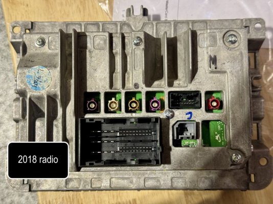

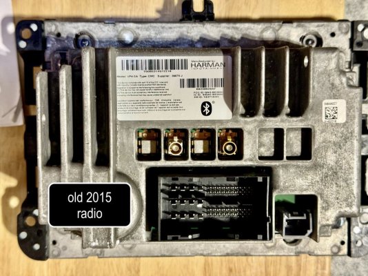

I own a 2015 Ram that had an 8.4 nav radio. I'm trying to upgrade it to a nav radio out of a 2018 Ram, but the nav system isn't getting any satellite signal with the new radio. I'm assuming the issue is because my old radio shared a GPS / Sirius XM antenna, and the new radio requires a separate GPS antenna. My truck only has 2 FAKRA antenna wires - FM radio (cream color) and Satellite (curry color). The new 2018 Radio has many more FAKRA antenna jacks. I'm hoping I can just buy the required antenna and plug it in. My main question is, which jack is for the required antenna, and where do I buy one? ...And if any of my assumptions are wrong, I'd appreciate any advise from knowledgable members. Here's images of the back of both radios showing their FAKRA plugs.IMG_4797.jpegIMG_4798.jpeg

Nope. Same setup, your old radio just had missing Fakras. The mustard plug is your GPS/SXM antenna connector. Do you get satellite radio reception?
Yes, the satellite radio works works excellent, even in the concrete parkade, but the nav keeps searching for signal when under clear blue sky... also my USB hub is not working.. I bought the Compass style on Amazon. Was that a mistake? should I buy the 2018 Ram style one, even though it won't fit my console?

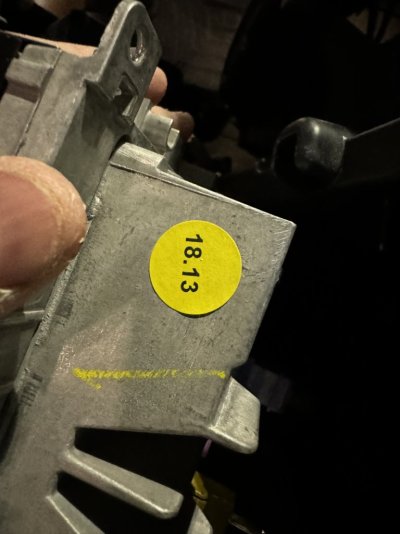

View attachment 552322Found this sticker on it, but how do I know if it’s ever been updated? I bought it used from an auto wrecker.
That's the firmware level it left the factory with. If you look in the dealer mode menu (hold temp up, temp down and defrost for 5-10 seconds) with the radio powered on the menu will appear with the currently installed "application version"...

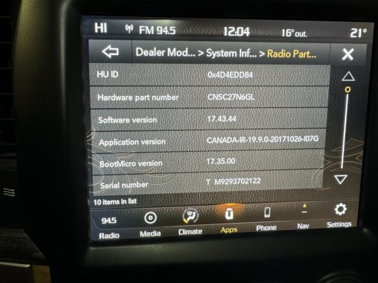

Ok. Holding those buttons worked!
So now how do I update? Or is it fine? Thank you so much for all of this help by the way

You are on version 19.9 which is pretty old. There are several firmware versions to get you caught up. While firmware may correct the issue, it can also fail and leave you with an inoperable radio. PM me if you would like to try the firmware route to fix it.
