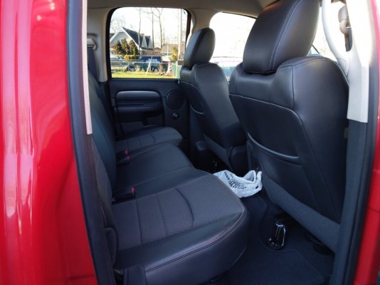

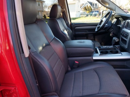

If you want a straight bolt in, look for 06-08 seats. 4th gen (09-19) seats will physically bolt in but then you have to sort the wiring. A real score for you if you could find them would be 2006 SRT Ram seats, but they are rare since that was the only year for those particular seats:
Now the older 3rd gens (02-05) look different inside than the later ones, but this is what 4th gen seats and console w/floor shift look like in one:
View attachment 481537View attachment 481538View attachment 481539
