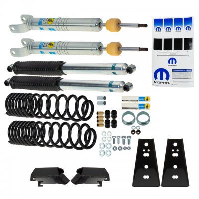

The solution I usually suggest to people is the Mopar 2" kit. I have no idea why that's such an unpopular suggestion but it just is, I guess everyone wants to be contrarian or something.
The thing with the Mopar kit is that you don't have to trust me or any other internet Rando about it because Mopar is the official accessory brand of Ram/Dodge/FCA/Stellantis/whatever. Yes I installed that kit and have first hand experience with it so I can say it's great but you don't need to trust me about it, I might be an idiot. I'm sure somebody's gonna read this and say yep you sure are! :sleepy: But the fact is that's also the kit that Ram dealers will install on the truck as a dealer installed accessory and have to be liable for it working correctly.
The Mopar brand isn't a guarantee that it's the best thing in the world but it is a guarantee that the part or kit just plain works when installed correctly so you don't have to worry about making a mistake. If you just want your truck a little taller and a little more capable than stock with no surprises that's a one click solution with Mopar's signature on it and at least in the USA it's well under $1000 delivered. It consists of front Bilstein 5100's, rear extended length 5100's, rear progressive rate coil springs, rear bumpstop pad extensions and brackets to relocate the sway bar end links. It's minimal, but it does significantly increase rear suspension travel (more than 10%) and it rides very well.
New upper control arms aren't necessary with lifts of about 2" or less (so Bilsteins at the 2.1" seem to align just fine with stock arms and that is my first hand experience along with reading the same from others) - taller than that, aftermarket arms are pretty much required to reliably get a good alignment. A lot of good choices there, I went with the Readylift arms because they have a sealed ball joint (not an open uniball) and my experience with them has been good, I would get them again and I would recommend them to friends. Not a good idea at stock height because they have lift correction built in, but at ~1.5" or more lift with stock knuckles they've done well for me for ~4 years and I expect they will continue to work well. I don't actually NEED arms I'm at about 2" of front lift but for a while I was trying out 2.8" and needed them for that.
Note that no matter what rear shock you go with, the upper nut is in a real pain in the neck location and you will need either a 21mm crowsfoot wrench or a specialized tool to remove it. The specialized tool from Thuren consists of just a piece of water or laser cut steel with a hex cut out of it for the nut and a bent tab that intersects with the frame so it holds the nut while you turn the bolt on the other side - they also ship a pair of nuts welded to two more of that tool as part of the kit. You can't just fit a socket over the nut and you can't fit any kind of wrench in there with the bed on the truck unless you have a body lift.
