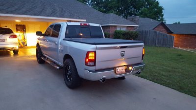

Has anyone swapped the factory incandescent taillights, to the factory LED taillights and what's involved in making it convert over?

It's a very common upgrade for the 13 to 18 Rams. You will need to order a conversion harness from Retro Shops. It will come with the correct resistors to make it a plug and play install

What have most people swapped to the Sport or Laramie? Aren't the sport lights tinted?

It's all a matter of personal preference some people like this Sport style some people like the Laramie. I ended up running the Laramie style in my truck but to each his own. Retro shops also makes the conversion harness to install the factory projector headlights as well. You can also get them in the Sport tinted style or the Laramie clear style

what about the 3rd brake light?

You can install the Ram factory LED 3rd brake light with the cargo camera option but they're extremely expensive and hard to find. I actually installed one in my truck and made it work but you have to enable codes in the BCM plus a lot of other stuff. I would recommend going with an aftermarket 3rd brake light if you want the LED but you're going to have to run and inline resistor so you do not get brake light out warning messages on your speedometer screen.
