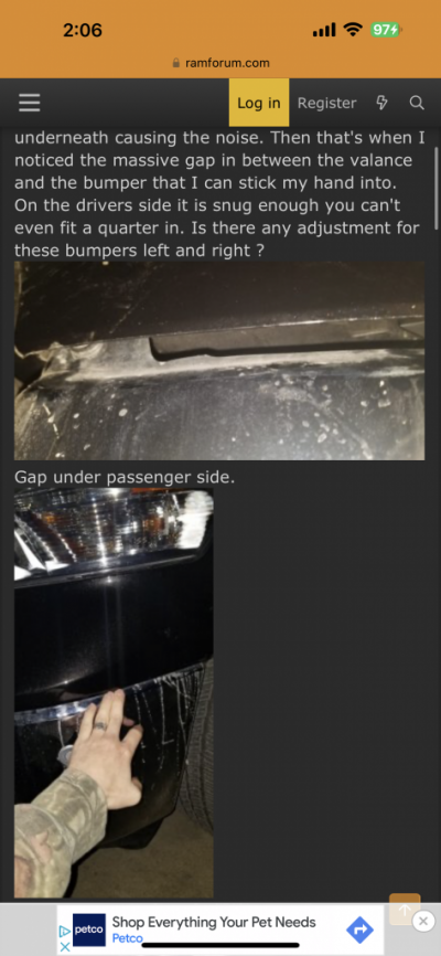

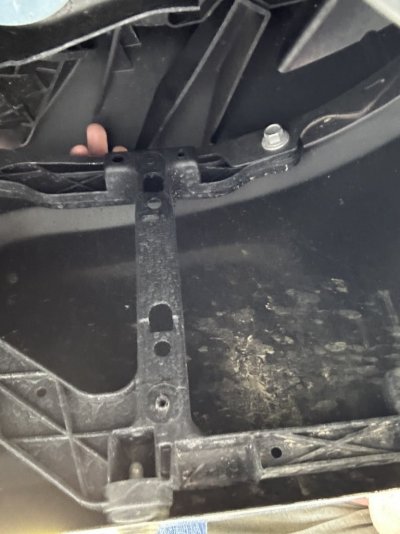

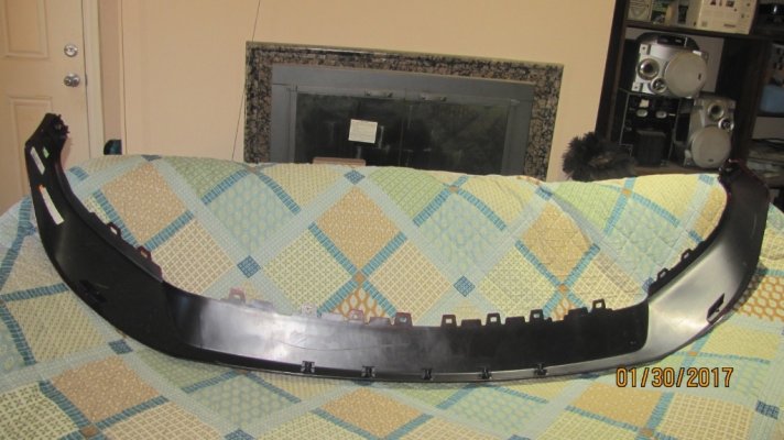

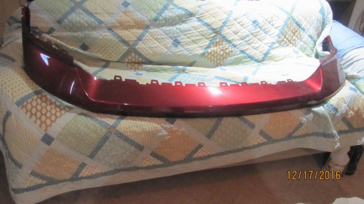

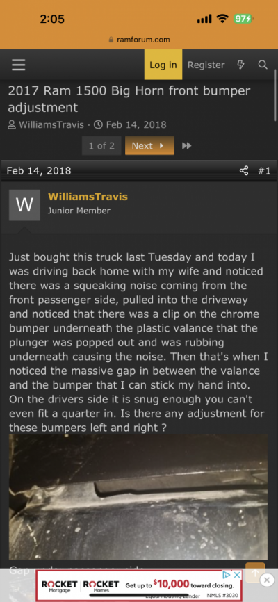

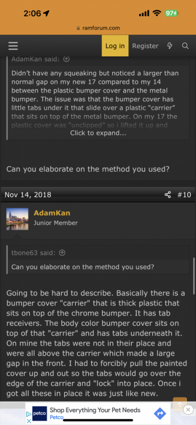

After doing more research found someone with a similar problem and a few pictures. First pic is mine with my hand coming in driver side under bumper cover valence. I can fit my hand between the bumper cover valence and chrome bumper itself on driver side. Bumper itself is straight.

I have a similar issue on my 19.. pass side has a bigger gap than driver.. but when I park the truck 100% level, and take a level to it, the bumper is level.. checked my coworkers 19, and he has the same issue, just not as bad as mine ... I'm just too lazy right now to try and mess around with it.
