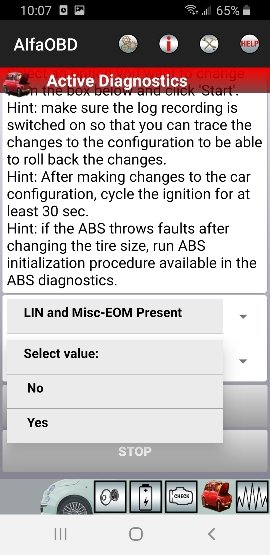

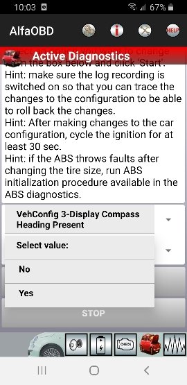

You will need to enable the EOM (electric overhead module) code if you want the Homelink to work and the Compass module code if you want the compass to show on the radio and speedometer. You can do it with the Alfa tool or possibility have the dealer do it. In some cases the code is not visible to the dealer depending on your trucks trim level and options. The Alfa tool can enable the codes regardless on the 13 to 18 Rams. If you have the complete harness it should be a plug and play after the codes are enabled.

No, you would only need it for the unlock code for the radio. Installing the Homelink/Compass module doesn't requre any unlock codes. Enabling the codes with the Alfa tool is easy. You may need to clear the Homelink of any garage doors it was previously programmed too. After you set the EOM code you can press the buttons. If they say transmitting in your speedometer EVIC they are programmed and need to be cleared. You just hold the buttons down in a certain sequence. Its It's explained in the owners owner's manual. These are the pics of the EOM and Compass settings in the Alfa. You may also need to set the compass orientation and mounting angle but it will most likely work correctly by just enabling the codes. 5d000a9a705c3b7ee9fc5b242b9914b7.jpg1819b2a977d32d0da3cfb2ad517f8b65.jpg
