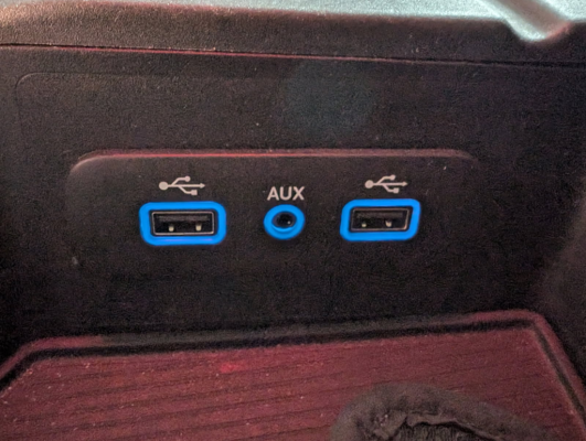

I have a '22 2500 Big Horn that was a rental truck, The USB ports on the Uconnect 5.5 are not enabled, they will charge my Ipod but that is all. How do I get them to work, I would like to hook up my Ipod again?

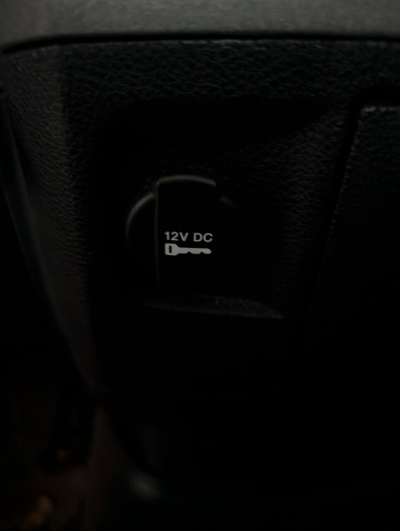

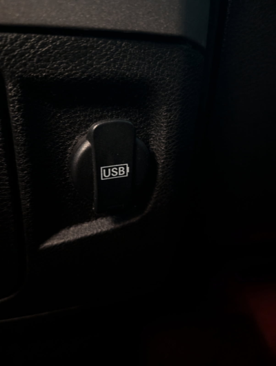

Not all USB ports are connected to the radio and are meant to be charge only. Only the ones in the Center console with the USB symbol (looks like a sideways trident) connect to the radio. That symbol denotes data transfer. If it has a lightning bolt or a battery on it (or even text that says something like 12v) it's power only.

Yeah, I was interested myself and tried seeing the specs but found nothing. I'm pretty sure it's wired to the same circuit as the dash/center console 12v cigar lighter plug but don't no if there is something internal to the USB port itself that outputs 5v DC. I'm not too up to snuff on the specs for USB, but I'd think the charge only ports don't even necessarily have to meet the spec'd requirements for USB 2.0/3.0/3.1 etc because they are not carrying data (am I completely wrong in that logic?)...

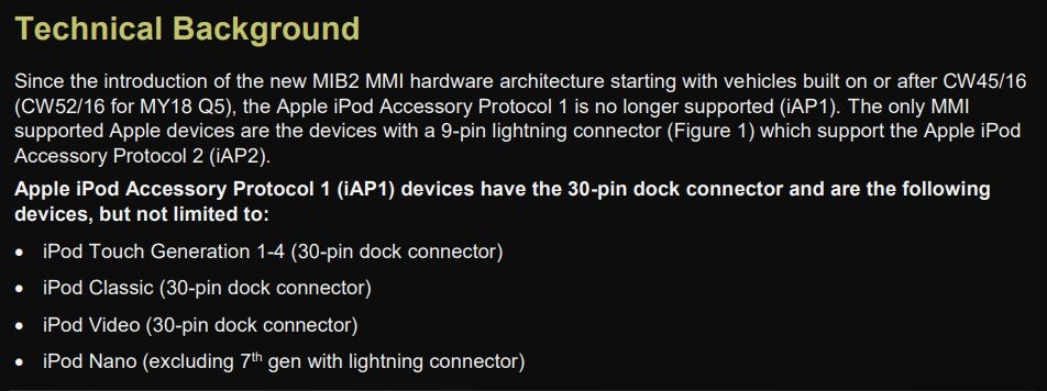

Was your ipod working previously or is this the first time you are trying to use it? I ask because I was looking to connect mine and I dont think the radios support ipod playback over usb anymore. I don't think there is an issue with your usb ports, I just dont think the radio supports the ipod anymore.

We will need more detailed information to answer your question.
Specifically, how old is the iPod device and have you used it successfully with a recent model of a Ram Uconnect radio?
I thought, how could this no longer be supported?
Trying to find that answer online was some effort, maybe I'm having an off day with my google-foo. BTW, I never use google. :cool:
To make a long story short, some of the legacy iPod devices that use iAP1 are no longer supported. iAP1 aka 'interface accessory protocol' is no longer supported by apple.
It has been replaced with iAP2.
As far as I can determine, support for iAP1 was discontinued sometime in 2018 but may have continued to function on older Uconnect radios before they were updated.
This is another example of why performing unnecessary updates can create grief.
If its not broke, don't try to fix it! :cool:
