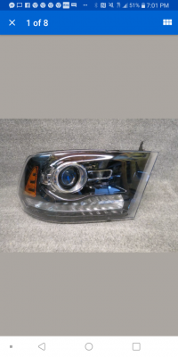

Ok so i finally bought used factory projectors. Surface are is like new, passenger light is missing 1/2 of the mounting tabs so i can still mount it. Driver side is missing all tabs, and has condensation. Will i have to unseal the the drivers side to get condensation out? I hsve heard inserting silica packs works, but where exactly do i insert them?
I only have a pic of the passenger side. Not fogged up drivers side. I paid $300/pair.
