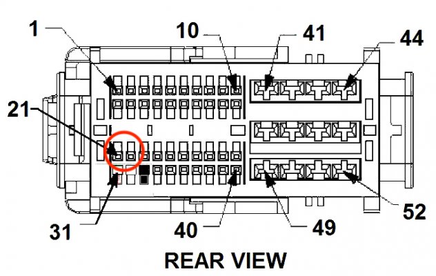

Thanks for the quick call today. Just to document it here for others adding a front cam on a Classic, Mike clarified that the newer trucks need to be pinned to positions 21 and 22, not 24 and 25.

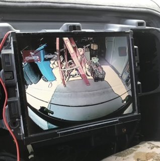

I'll repin mine tomorrow and will report back hopefully with a photo from my front camera.
Success! ProTip: use an X-acto blade to depin your leads if you need to move them. My smallest jeweler's screwdriver was too big to release the tab in the slot.

To add to this, it's actually radio model Year specific ...
It only applies to 2018+ Panasonic radios (newer SW) for pins 21,22 (&23) for Cargo/Cam2.
If you are using a 2013-17 RAx radio (in any Year truck) the Cargo/Cam2 input is on 24, 25 (&26).

What do you mean by pins 21, 22, (&23)? What is pin 23 used for?

Signal, Signal Rtn, (& Shield)
(Standard RCA doesn't have/use the shield wire like the factory)

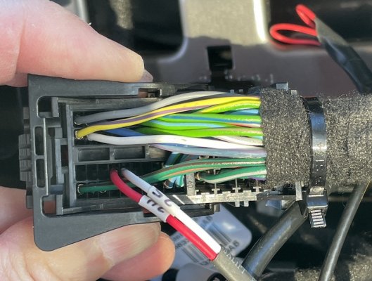

I had a black screen when I first powered everything up, and it turned out that the pins you connect the RCA pigtail to on the radio are different on later model trucks. Once I repinned my pigtail, it worked fine:

Another question, what did you use to seat those pins all the way in ? I can't get them to seat all the way in which might not be allowing for a good connection ?

The pins will only seat fully if oriented properly. If yours aren't going in all the way, don't force them! Try rotating them 180° and see if they'll go in all the way. You'll feel them "click" when they seat fully.
I had a bear depinning mine to move them to the correct locations - had to use the tip of an X-acto knife to release them.
