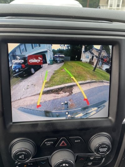

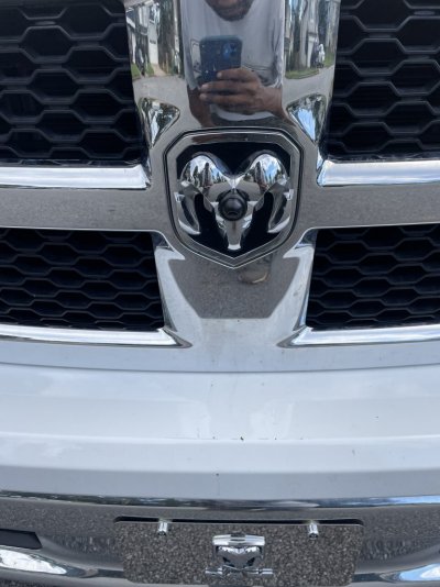

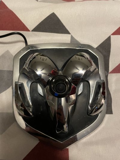

I have already posted it before but I am very happy with this camera https://www.amazon.com/gp/product/B078PLLN7F/ref=ppx_yo_dt_b_search_asin_title?ie=UTF8&psc=1 ha s number of different mount choices and the image is very clear. I did exactly what you want to do with my 2015 so no bypass needed fortunately. It is a little tricky to get it all wired up fortunately I had a friend do that for me. I grabbed power from the 12 volt plug on the left side of the dash for my camera. Using Alpha BD to turn it on is pretty easy. I look it looks good is barely noticeable. You can PM me if you have more questions.

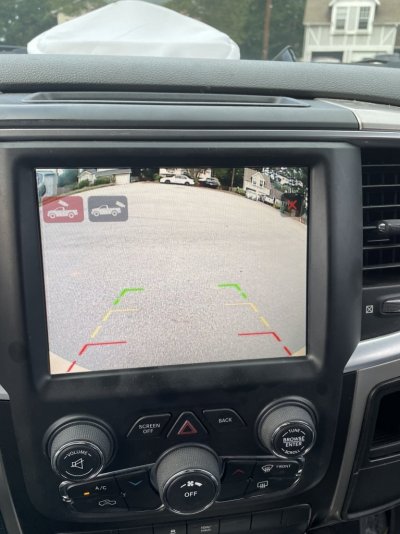

Anyway based on NapaRam's post, I went ahead and purchased the AlphaOBD app. The app worked with my ELM327 OBD reader and I was able to activate the cargo cam on the head unit. I'm looking over several camera options and deciding on either building my own rca pigtail or buying one.

Thanks to you @Mpgrimm2 for supplying the Pigtale to make it all work. Easy Payment and fast shipping!!!!

Once enabled with AlfaOBD, the cargo cam icon should be visible on the Apps page on the radio. Press and hold the icon until it becomes moveable, then continue pressing and drag to the icon tray at the bottom. I did this today with my tailgate camera icon, and will add the cargo cam once I get the pigtail and camera hooked up.

I installed my front camera today (Coolint CT106S) and used AlfaOBD to enable VehConfig 1 - CHMSL Camera and CBC Features - LED CHMSL Lamp Present. The Cargo Cam button became available on the radio after an hour or so, but I'm getting the "Camera System Unavailable" error instead of video.
Too late to go mess with it any more this evening. I'm 95% sure I pinned my RCA pigtail from @Mpgrimm2 correctly (positions 24 and 25), but I guess I'll pull it back out and recheck tomorrow if the video doesn't automagically appear by then.
