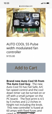

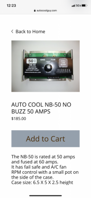

Yea you’re better off leaving the mechanical fan if you’re trying to save a few bucks. The controller I use currently is a nb-50. Their is a cheaper one. The autocool55. Best bet is a tuner. I did this for full control. The fan does not just turn on and off. It will run at a low speed from around 160° or so depending on what you set and gradually increase as needed to maintain whatever you set as your desired temp. My truck hardly ever goes over 199°. I have a 190° tstat. I have noticed while cruising my fan may not even turn on or will run at the minimum fan speed instead of cycling on and off like the stock fan. You have to wire everything yourself which if you’re knowledgeable about electrical than you would be fine. The controller I am testing requires a different fan and a whole wire harness and module which as a package is about 700$.
