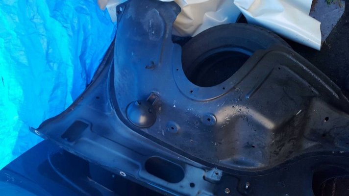

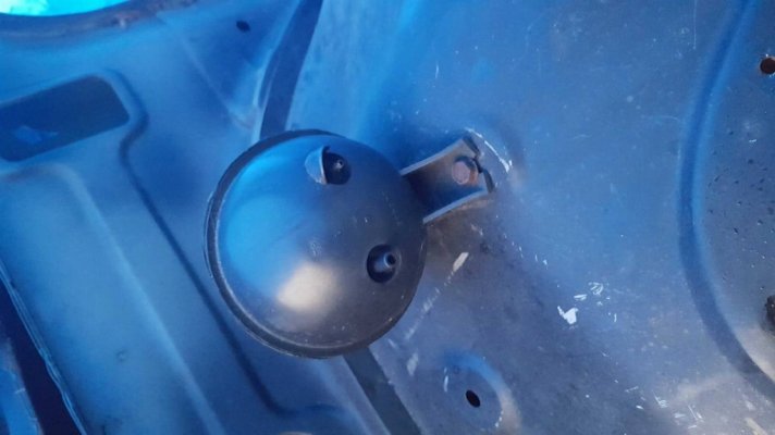

Tried looking around but can't find answer. Is this factory or something somebody added? It was connected to the manifold and the climate control but I can't find it on any of the parts sites or by searching.087d5b099feb45fd3fbbe49be77c79ae.jpge3b055e1e2c790deb5e0c3f90b29323a.jpg

Those are aftermarket. Supposed to help control the wild vent issue these trucks have, losing vacuum to the mode doors in the HVAC under heavy throttle.
