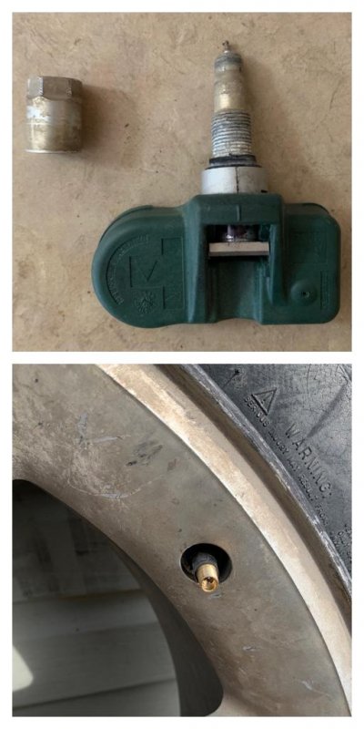

Was putting air in tire and the tip of it just broke off.

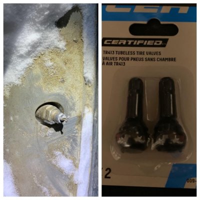

Where can I get the replacement part, and will a regular one like in the pic work for now til I get the real part ?35f4ca5448ae9fde9049e8adb0a16db8.jpg

Walmart or most tire stores can sell a generic TPMS and program it to your truck. Walmart charges $35 around here, but of course, their Auto Care Centers are closed right now.

To install a rubber one, tire beads needs to be broken and installed from backside then tire balanced(ideally). Might as well get it replaced the right way and save some money in the long run if it is a tpms setup.

Looking at the pic it is a tpms valve stem.

I removed the broken valve stem and replaced it with a normal one temporary, until I can order a new tpms sensor with a stem.

Ordered from rock auto. I hope it still gonna work.
Cheap aluminum, had hard time off screwing the old one. Will anti seize work for future removal?
