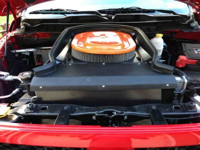

Picked up one of these intakes for my '13 ram off a member on here and got around to installing it today.
The system seems very wobbly and i noticed that the flap/scoop covers up the top of the radiator. Wont this risk causing over heating?
The scoop concept seems poorly engineered, cant see this kit flowing air much better than a closed unit. I mean its just a plastic flap that hangs in a empty space after all.
I figured after all the rave reviews this intake gets on here it would be a better quality kit than this? Hopefully someone can chime in on all this.

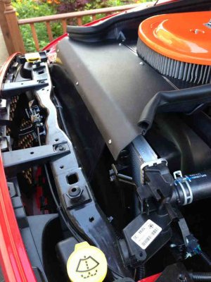

Some pics that might help.

The lower "wing" is installed backwards. The notched corner should be on the passenger side of the motor with the textured finish facing forward. As for cooling, there is plenty of the radiator exposed, so there is no issue there. As air comes through your front grille, it builds a pressure bubble that forces air up and into the filter tray. With the tray sealed off to the hood, that air has nowhere to go but straight down your throttle body.

Ahh good to know! I will have to fix it in the morning.
