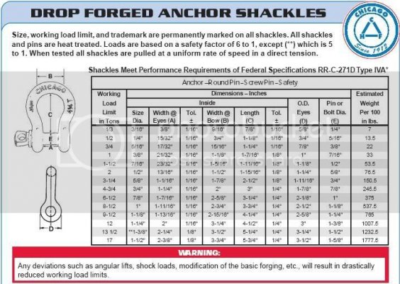

Make sure the strap has a label stating its strength and manufacturer's information stitched in the webbing. Your rig has to be able to handle all these pressures of being ******. Use suitable tow hooks that are properly fastened and can handle the load. Do not use a trailer ball as a recovery point as it can break and become a deadly projectile. I recommend a “D” ding shackle/clevis of some sort in the receiver hitch as a suitable recovery point. See bottom of page for load ratings.

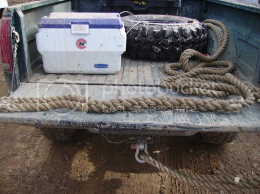

Some people also like to use big rope for recovery which is fine too, so here is what you need to know. How to make an eye splice, and the ropes strength. A knot reduces breaking strength by 40% while a splice retains 95% of the ropes strength. Most people say the rope will break before the eye splice will come apart.
Here is a picture of the splice, literature will follow.
Step 1--Tape the ends
Cut rope will have been sealed with a hot knife to prevent the ends from unraveling. To make a splice, you need to unravel a short length of one end, but you do not want the individual strands to unravel. Put a couple of wraps of masking tape around one end of the rope and slice through it with a sharp knife to cut off the melted end. Untape the rope and tightly tape the ends of the three individual strands.
Step 2--Unlay the strands
Pick one strand (it doesn't matter which) and unwind it, making eight revolutions around the other two. Tape the rope tightly just below where this "loose" strand joins the others. Now untwist the other two strands.
Step 3--The first tuck
Form a loop in the rope the size you want the eye. The splice begins at the wrap of tape on the rope, so this marks the closing point of the eye. If you are doing an anchor line, make the loop tightly around the thimble. I generally secure the thimble in position with a wrap of tape on each leg. With the loop formed and the unlayed end on top of the standing part and pointing away from you, fan the unlayed strands naturally, i.e., with the center strand leading directly away from you, the right strand spread to the right, and the left strand spread to the left. Commit to memory that the first tuck is always the center strand and you will avoid confusion in the future about the start of splice. Lift a strand on the standing part of the rope at the point where you want the eye to close and tuck the center strand under it. On smaller and/or soft-lay rope you will be able to make the tucks just using your fingers. Large, stiff, or old line may require use of a fid or marlinespike to open the strands in the standing part of the rope. Pull this first tucked strand all the way through so that the eye is closed, but don't pull so hard that you distort the lay of the line.
Step 4--The second tuck
The second tuck is always the left-hand strand. The strand on the standing part it goes under is the one above the one you just tucked the center strand under. I remember "left-above" to keep me straight. Again, pull all of the loose strands through.
Step 5--The third tuck
This is where you are most likely to go wrong, so be careful. If the left strand goes under the "above" strand, then the right strand must go under the below strand. The confusion is not which strand, it is which direction. All tucks go right to left. The easy way to avoid doing this wrong is to flip the eye over to tuck the third strand. Once this third tuck is made, pull on all three strands in turn to snug the closure of the eye evenly.
Step 6--Over and under
The rest is easy. Pick one strand and tuck it under the strand on the standing part that is two above the one it is already under. In other words, each strand goes under one strand, over the next one above it, then under the next above that. Tuck each loose strand in turn, one tuck at a time. Turning the rope counterclockwise about a third of a turn after each tuck will help you keep the sequence and the strands straight. Give each strand a total of six tucks. Once all of the tucks are completed, place the splice on the floor and roll it back and forth under your foot to smooth it. Then loop the eye over something and put a strain on the line. Cut off the projecting "tails' of the strands and the splice is finished.
Literature from Don Casey at BoatUS.com: BoatUS Home Page
Finished product tested.
