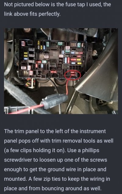

https://**************/community/threads/hard-wire-dash-cam-install.550/
It's not the best option but it is an option. Just go to your parts store get a female aux socket and wire it in maybe?
