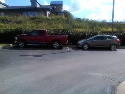

Many people use tow dollies and tow bars to pull vehicles, myself included. I used to use a rented tow dolly since the vehicle I am pulling is front wheel drive. I have used my 1500 to pull a Ford Focus from coast to coast, South Carolina to California to Washington to Virginia. I have confidence in my truck's ability to pull the vehicle and stop it even without brakes on the dolly. The costs associated with renting the dolly have made me realize I would have done better buying my own.

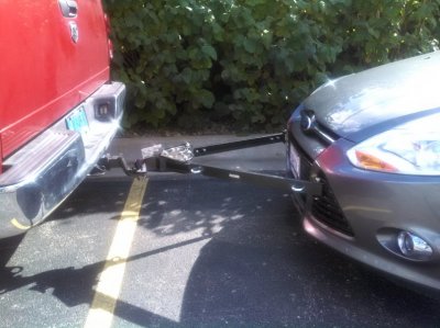

Doing research, I found out that my Focus was able to be flat towed and that I didn't need a dolly, just a tow bar. As I did more and more research, I came across a lot of misinformation regarding the law and the safety of vehicle towing. This is especially prevalent in web sites that sell overpriced devices designed to keep you "legal", but these devices may themselves be unsafe. Here is an example of such misinformation. What this site is citing is trailer towing laws, but they don't make that clear. If you put a car on a flatbed trailer, then yes, these laws do apply, but a car is NOT a trailer because most states say that a trailer is a vehicle specifically designed to be pulled behind a motor vehicle. This site is much more credible. Not only does he cite his sources, but he is not trying to sell you anything.
The safety side is a bit more grey. Many RV'ers who are driving 40,000 lb motor homes pulling a 3,000 lb car swear that supplementary brakes in the towed vehicle make a huge difference. Others cite burnt out brakes and fires from brakes systems that stick on and that the weight difference between an RV and a "toad" car is so large that it shouldn't matter. There is a point to that. After all, a 40,000 lb coach is not going to stop on a dime even if it's empty.
I am now towing my Focus with a tow bar. I wired the flat four connector straight back to the car's brake lights with diodes from Radio Shack. I do believe that this setup is safer than the dolly because while neither had supplementary brakes, the dolly added 700 lbs to the towed load.
