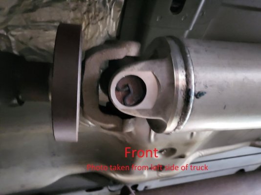

(This is a 2wd 4.7 2012 quad cab street truck by the way) As the thread subject says, after I did a gear swap I have a vibration and oscillation sound under hard acceleration. The sound is like rotating mass spinning - kind of like big 4x4 tires, even though I have low profile street tires. It's not very smooth. The shop installed 4.11 gears and posi track - yes the gears are 4.11. I changed out my tires, had other shops check the drive shaft and other possible problem areas. So, I took it back to the original gear swap shop (1 year later - had the truck in storage) and asked what could be the issue. The guy drove it and said it's more than likely a drive line issue. That possibly the angle of my drive shaft has to be adjusted or I have to have a new drive shaft fabricated because now the drive shaft is spinning at a faster rate with the new gears. That was his first impression.
It does make sense but that's more money for me to bring the truck in. HOWEVER, I don't think I have read about other people having this issue doing gear swaps. I'm not sure where the gears came from or the Posi track. I'm not the most vehicle tech savvy guy. I paid money and just told him to get the gear install done. The guy is definitely smart and has a good google rating for his business.
Has anyone else come across this problem?
