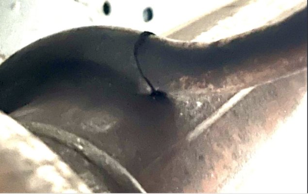

Maybe check the exhaust tie bar just behind the cats. Mine was broken and caused a vibration. I welded it and that fixed mine. I looked at this a couple of time before I found the crack.
