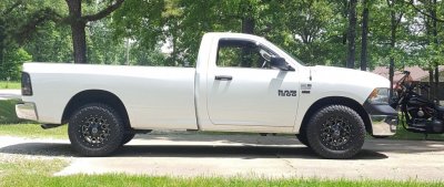

So, I did not take the leveling kit off yet, but did take off the Gladiator 35's and the factory wheels and mounted new wheels and tires and yes the wheels have hub centric wheels at that. The tires are 285's and I still have this mystery vibration going on at 55mph up, but the catch is its not all the time, like it syncs in and out and sometimes its constant. I am at a loss about it, but since I have the leveling kit on the truck Im pretty sure if I take it to the dealer they will void the drive train warranty since my truck is 2016 with under 25000 miles. Suggestions? Its a regular cab long bed 4wd hemi tradesman
SargeFirstClass
SargeFirstClass
Oct 23, 2016
208
149
Poplar Bluff, MO
Update: I took the 2" lift blocks off the front of my truck. Id say 65% of the synchronizing of the vibration went away, but now its a constant vibration from around 60 up to 80+mph. I think now if I go get a good road force balance and a new front end alignment from a reputable place this may finish out the vibration issue. I guess that 2" threw the front outer axle shafts just enough to be a real pain in the butt. Truck looks a little funny now, but it will do. 20180522_130056.jpg
