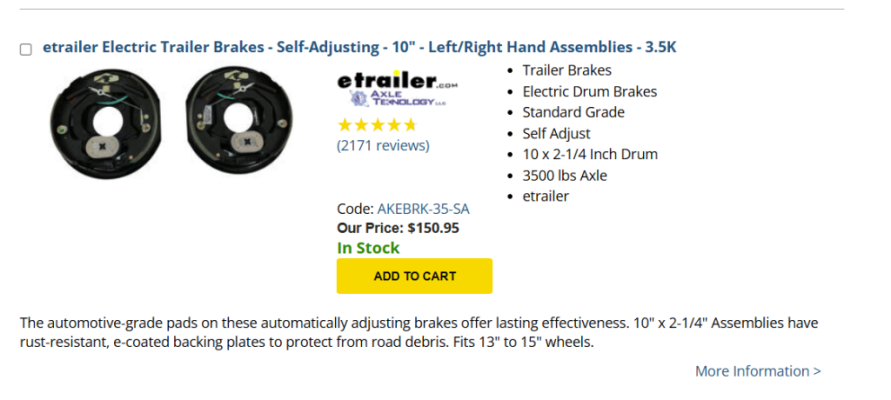

No idea when you bought your last trailer, but a 3500 lb single axle Cargo trailer with disk brakes vs one without is $1,000 more in price on a trailer that only costs $3,000 to start with. That is not insignificant on a cheap trailer that isn't packing much weight around.
Up here, all single axle trailers under 6000 lbs come standard with no brakes, they are optionally available at time of order. To add a set after you get the trailer is nearly $2,000. I have never checked what GVW on a tandem comes with brakes as standard equipment.
You can install trailer brakes much cheaper than $2k. On a small trailer I don't think they're necessary either, but if one were so inclined they could absolutely do it for under a few hundred bucks.
Drums are cheap, but I would never use them when disk is available. Drums are far too hard to keep adjusted and balanced. One drum grabbing even a little harder than the other is WAY worse than no brakes at all.

Drums work fine. Sure, discs are better but not a requirement. A quality set of self-adjusting drum brakes are cheap and easy to install to put brakes on a trailer that otherwise doesn't have them. My main point is that one can do this for far less than $2k.
The drum brakes on my travel trailer and the previous ones on my fifth wheels have never given any issues. I do a 10 minute inspection twice a year and make sure they adjusted and then move on.
