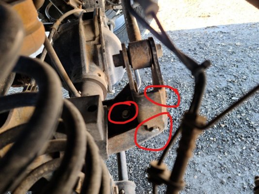

Wes Veness
Wes Veness
Dec 3, 2019
248
285
Winnipeg, Manitoba, Canada
2019 SLT Classic
Turns out I had three bolts sheered off. as soon as it was put up on the rack they noticed it right away. That fixed the 1" offset on the passenger back rear and put the cab and bed back in alignment. I have been working with the quality control from the insurance place and he said the 1st shop that worked on it is going to loose their accreditation. Here in Manitoba you have to be certified as insurance is Gov run so you need to be an accredited collision center to be able to do work on collision repairs. They should have never missed it the 10 times they were told to check my suspension. Now after 6 months though it is finally back to pre accident condition. 20220722_095450 (3).jpg
