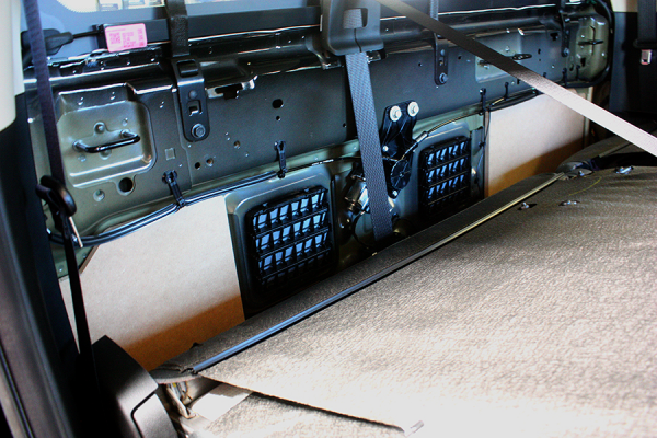

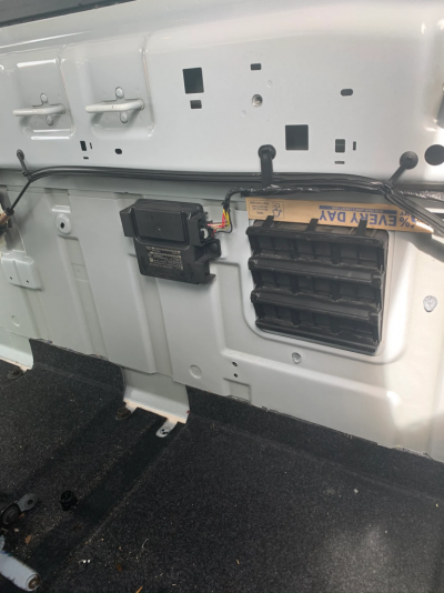

Well until I can get the rear seat out I won’t know for sure but being that the headliner is dry and after I watched a video about leaky cab vents, I’m thinking that might be my issue.
I highly doubt it’s my third brake light because I’ve already bought the good rubberized weatherstripping from Lowes and resealed it and as far as the sliding rear window I’ve heard about, I guess that’s a possibility also but I do know that water has been running down the inside of the back of the cab because sure enough, the storage pocket directly under the right rear of the seat is once again soaked and after further investigation, I noticed the carpet next to the back of the cab in the center is soaked. That’s when I saw a drip on the back wall. It did rain pretty good today and just this last weekend, I pulled my Stealthbox out and shampooed that right side pocket and even put a fan back there for almost an hour to dry everything.
Has anybody had this problem with leaky vents? I watched a YouTube video where a guy just took some silicone and ran a bead all the way around the outside perimeter of each vent from the inside of the cab but I’m not sure if that totally cured his leak.

I haven't seen much behind the seats so I'm not totally sure where its coming from but I could tell as I was looking under the rear seat that there was water running down the back of the cab.

The sliding window leak usually happens when your cab leans toward the drivers side during a rain.
On some Rams They only put one drain in the window track, it really needs another one on the drivers side of the sliding window
The drain on the passenger side of the slider can be plugged
a stiff wire might be used to open it back up
the drain goes from the bottom of the track, through the rubber seal around the window, the low side of the drain passes under the glass & comes out of the rubber seal outside

You really just need to get the seats out and watch. I would just order new vents for piece of mind. They are really cheap, if you can get them. I had been fighting water back there for a while coming in the sliding window. Cleaned the drains several times. Finally I just ordered new seals for the sliding window and I've had rain all week and no water running down the sides. If the drains work ok, they can't handle the volume of water being let in. Mine looked fine too but it made a huge difference. It would fill the track and spill over into the corner of the window.

Where are the drains for the sliding window? Have you messed with those vents before? How do you get them out and how exactly do they seal against the cab?
It’s supposed to be nice this weekend so after getting the seats out, I’ll run the water hose on the back of the cab to pinpoint where the water’s coming in.

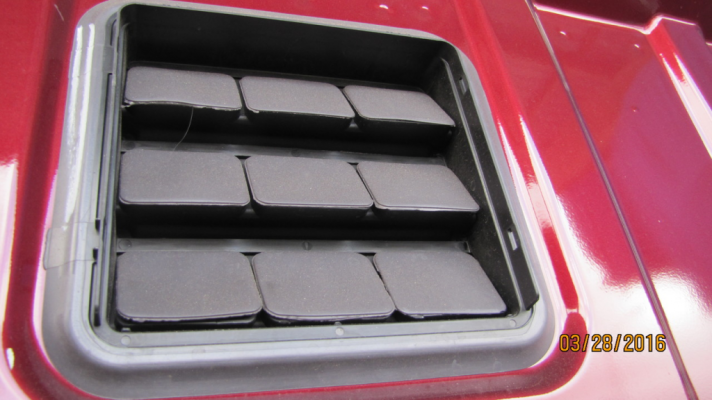

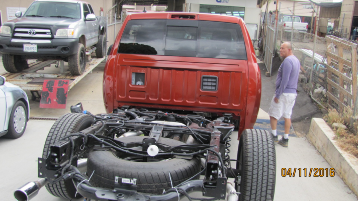

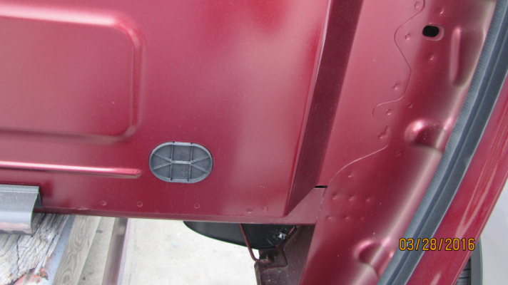

I have wondered about the back exterior of our Ram cabs
The replacement Vents are designed a bit better than many of the older 4th Gen
I don't know when that change was made
Most of you have seen what the older vents look like
My 2016 Ram

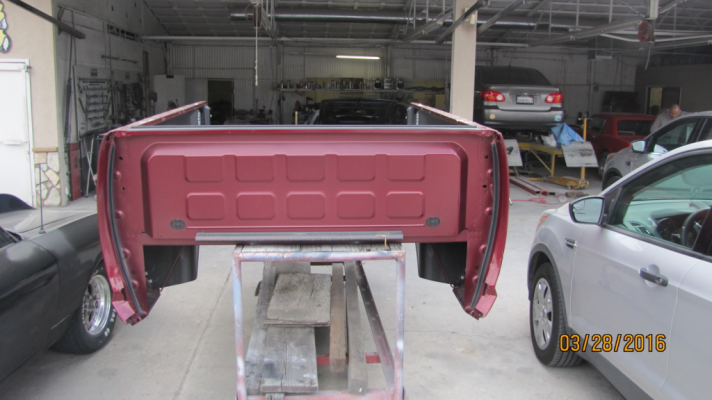

on the bed, there are 3 rubber strips
there is a horizontal strip along the bottom of the bed
there are 2 vertical strips, that i think keep water on the road from getting between the cab & the bed
I wonder why Ram did not put another rubber strip along the upper part of the bed
It would keep a good portion of the rain water from dropping down onto the vents
There would still be air swirling between the cab & the bed, but i believe that there would be less water near the vents.
I believe the 5th Gen Rams have the vents closer together on the cab & they are larger in size

Thank you for those photos, @GTyankee.
In that third pic from the top that shows the extreme closeup of one of the vents from the outside of the cab; is that entire outer perimeter one big rubber gasket?
If there was ever a design change in them things, you’d think my truck’d have it being that it’s a 2018 model.

I have not had a vent in my hands, but i would think it would have to be plastic with a soft rubber seal
several members have upgraded their vents, maybe someone has noticed how they are constructed

I have replaced the cab vents on mine. My 2018 had the older style vents and the rubber flaps were getting stuck open. If you pull the seats you should be able to tell if yours has the same issue.
