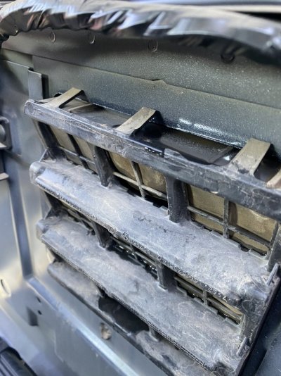

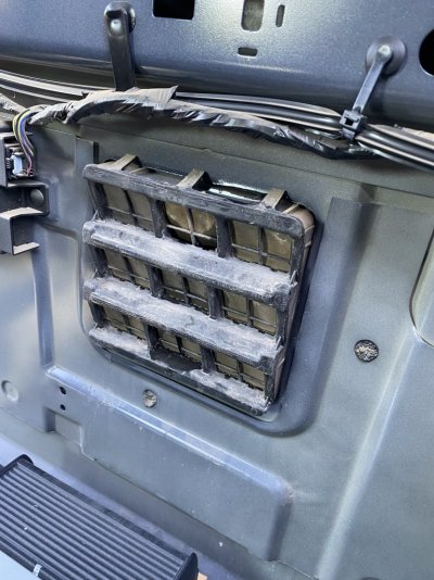

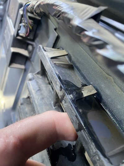

Well fellas, found my leak. Soaked the crap out of the truck and sure enough, the passenger side vent leaks worse than the driver side one does.
I know it’s kinda hard to tell but look real close at the top three little tabs on the top of the vent in the last two pics…. This is the driver side vent and in the bottom pic, I can pull the top of the vent towards the cab almost a 1/4 of an inch. No wonder the motherhumpers leak.

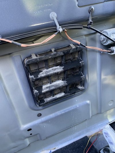

Well folks, cross your fingers. I got ‘er all fixed and put back together. I ended up using the trick @GTyankee used in his post where he stuck the paint stirring stick between the cab sheet metal and the little upper tabs on the vents to pull them tighter to the cab and then siliconed all the way around the vents so hopefully that seals them. And I did get my rear seat mod done too so hopefully in the unfortunate event my fix job didn’t work, I won’t have to pull the seats out again….lol.

I can not claim to have done the paint stick trick
It was just the best image that i could find, that someone else had posted
Awww, it’s cool my dude. I’m just glad you posted it because before I noticed how much slop was in my vents, I didn’t even notice that they had wedged a paint stick up there like that and if I hadn’t of seen it, I probly woulda racked my brain for about an hour trying to find some way to suck them vents in closer and tighter to the cab.

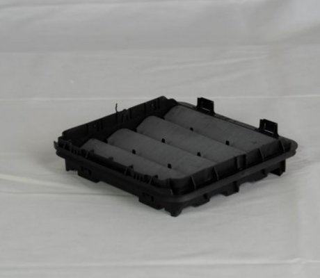

So being that you have a 2018 like I do, what did your old vents look like and what do your new vents look like being that you said they have a different flapper design? Was the gasket on the other side still the same as the old one? Does either your old ones or your new ones look like the ones below? I guess if they did use the older style cab vent on my truck, I could probably try the newer style but that’s just it, my issue was from water coming in between the top of the air vent and the top of the hole that the vents snap into.

Iirc old design had 9 individual flaps and the new had 3 (1 per row vs 3). The material for the flaps was different as well. Mine you could see light thru some of the flaps.

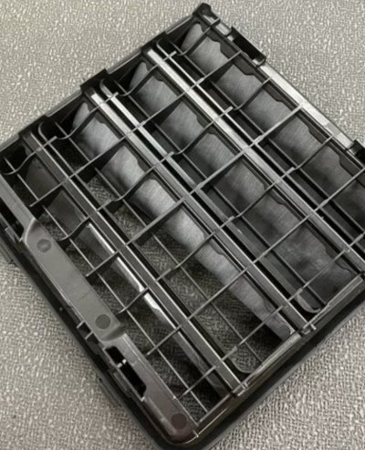

Well fellas from what I can gather, 68157351AC is one of quite a few part numbers for the old-school air vent which is definitely like the ones that my truck has that @CamperMike pointed out that just has nine individual flappers and part number 68323649AB is for the new one that supposedly looks like this.
