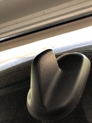

Can you tell if the leak was coming from the top of the outside seal gasket next to the actual antenna or the part of the gasket closesest to and that seals to the paint? I see a rubber gasket on the bottom before the actual plastic antenna to clarify what I mean. I have attached a picture of a shark fin antenna I took when doing a test drive to make sure would fit in my garage. I have a Ram 2500 CTD on order.

Hello Mark,
I could not precisely tell whether it was coming from between the paint and gasket, or antenna and gasket. However, I did note that the gasket was firmly affixed to the antenna, but was definitely loose on the painted surface.
By the time I had gotten home and dismantled it, there was definitely water inside the perimeter of the outer gasket, (one you can see from the exterior of the antenna) and obviously since there was water inside the cab of the truck, I deduced that it had permeated the inner foam gasket as well.
I applied silicone on both gaskets.
