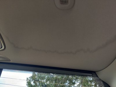

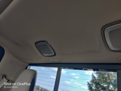

2021 Ram 1500 Limited.
14 miles when I grabbed her Friday, and found two problems today.
A. Rear head rest are different materials
B. Water leak in the head liner.
Third brake? Moon roof? Guess we will find out Thursday when I drop it off.
How many others are having this experience?

That's not very encouraging @Musky Mike
Maybe I should just dump the truck and get a hellcat? They probably pretend to be fake ass water balloons too. I'll bet with the tan interior, they spray a chemical cleaner on and call it good. SMH!!! Love the truck but am second guessing I'm favor of lemon
Quite a few posts on here about the leaks, they do tend to steam clean the headliner and reinstall it. Some trucks have had a lot of rust on the back seat mounts and there is some electrical equipment under the rear seats that affect starting of the engine. I would use the search function and see what's happening to the other components that you can't see that got wet and make sure the dealer repairs them and not just the water intrusion problem.
