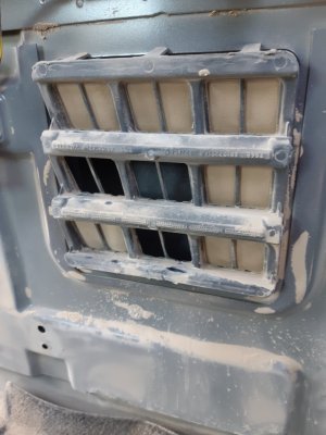

I would say rear sliding window frame cracked, or Cab vent flappers bad, take a hose to rear window and see if its coming in.

The 3rd brake light, rear sliding window, cab vent and the roof mounted antenna are all culprits and have been know to leak on just about every pickup from every manufacturer. Get a garden hose and start checking everything I mentioned. You may have to remove the rear seat to diagnose it

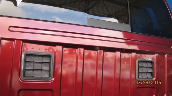

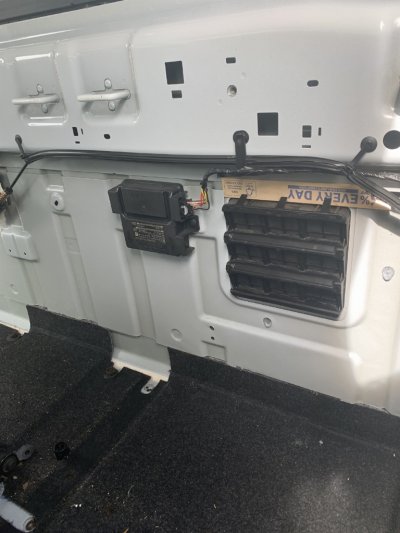

2008 Dodge Ram will likely be the 3rd brake light or a sunroof,
with a possibility of the rear cab vents
the paint stick is shimming the vent against the cab, to seal out water
Cracked rear window frame is actually from the years 2017 - 2019
