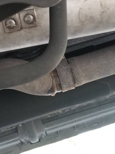

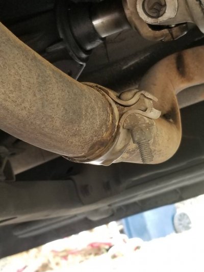

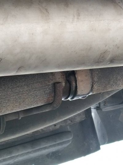

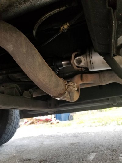

So I lifted the truck today in the morning and I notice I had water coming out of the exhaust connections..... do you guys have any idea ? Is it normal ? 444d8a512f0c6b2b3b88863aa7feb046.jpgba23b8014c42934bc0ef7f68a8e4d000.jpg29d5f112380dd77a68b744793d645553.jpg9ae057a2f85d9e588743169157c09a55.jpg

Yea probably condensation

That's what I thought but damn it seem like a lot ... just wanted to double check

Mine drips from the muffler pee hole every day this time of year

I had same issue with the stock muffler. Walked behind truck..wtf...big puddle. Coming from back of muffler. Its weird to see but normal
Oohh ok . Hahaha I was like crap what the hell is wrong now ...

As long as it's just straight water all it is is condensation, just so there's no antifreeze mixed with it. If it's just water all it means is that joint is leaking( exhaust leak). If you have antifreeze mixed with it probably a head gasket leaking.

Condensation, probably due to the higher altitude LOL. You could the tightening the clamp. If water is getting out, so is exhaust when its running.
