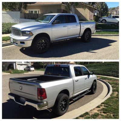

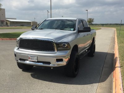

I think this turned out well. What do you guys think?
I added a Zone 4" lift with 3" rear coils to my existing Billsteins, lowering those from 2.8 down to 2.1. Also upgraded to the Zone UCAs. Then I swapped my Nitto G2 305/55/20s for 35/12.5/20s and went from 20x9 +1 to 20x10 -24 Fuel Mavericks.
First photo is before - leveled with just the Billsteins and 305/55/20s.
I have a Diablo T1000 w/Hemifever tune and Sean has me set up nicely for a 93 tune with these 35's.
Next up (and a different post) is gear swap from 3.55 to 4.56 and LSD. I have these now (thanks Matt/Moe's), and when my Redline fluid comes in next week, truck goes into the shop for the gear upgrade.
Also ordered the ARH LT 1 3/4 headers from Matt/Moe's and when they arrive, gonna send em out for ceramic coating (I will put up a different post on that as well).
After another tune, and with this lift, the gear upgrade, the LSD, the headers, this is gonna be a different truck altogether! Wife has effectively put me on a leash now.

Looks killer! What kinda grill is that, and how much you spend on it?
Thanks. Smittybilt M1 but I removed the emblem. I think $300 and factory grill cut was needed. Very durable and easy to clean.
