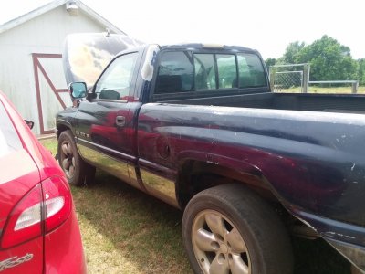

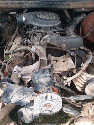

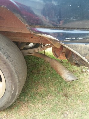

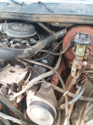

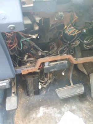

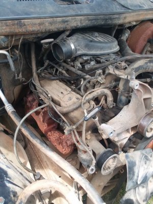

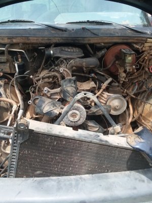

Well seems its going to rain so I'll get a few pictures because I left the windows down and the hood up.
