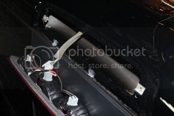

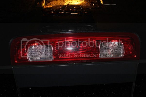

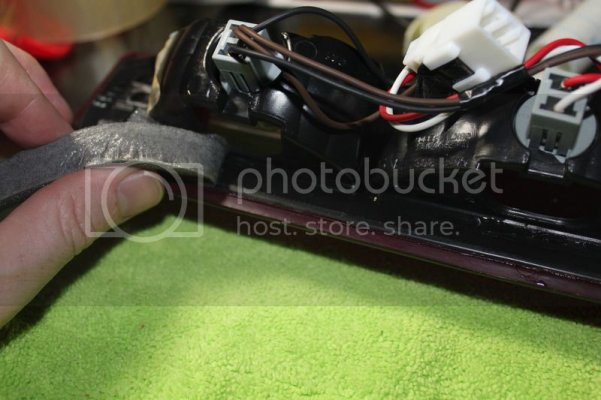

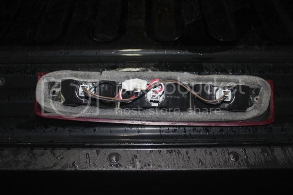

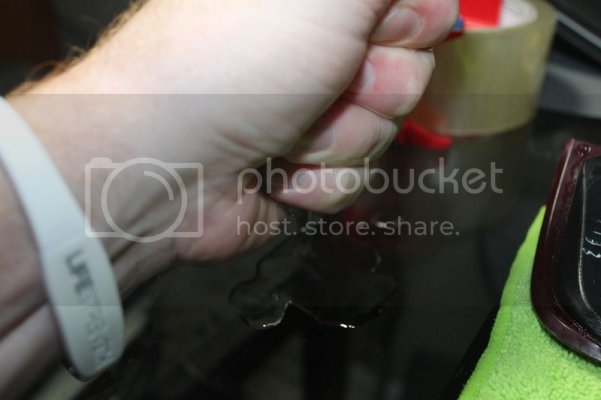

run to lowes and grab a pack of the M-D Building Products 0.59-in x 10-ft Black EPDM Rubber Window Weatherstrip
is it what i used after seeing on another forum and that stuff works great here are the pics from after bring my truck to the dealership and them not fixing it correctly.
after noticing the water leak in my truck called the dealer brought it in for repair, wow sadly mistaken for being fixed here are the photos as proof.
you can see the poor attempt at fixing by the use of sliicone
once again condensation in the light
you cant really notice it but there was a pool of water behind the light
here's the proof, a poor poor attempt using a trash foam for repair and a crappy attempt at that fixing a problem.
this is the finished product, it has been on the truck for probably 2 months and there has been a few monsoons come through south Louisiana and has not leaked once. the material is almost 3 times as thick as the original gasket, works for me.
