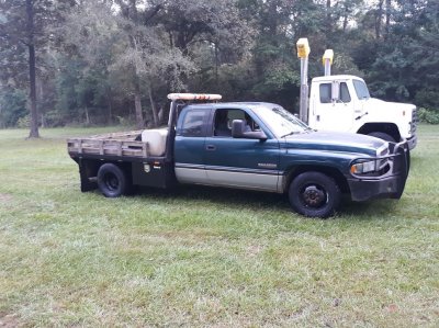

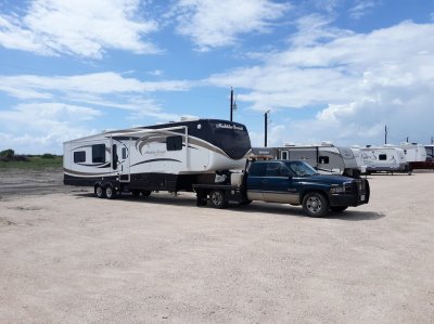

well over this weekend i did a full dually swap, i already had 1 ton springs, overloads, and air bags, so i swapped the entire rear axle out add modified oem spacers to the front and put 6 new tires on.

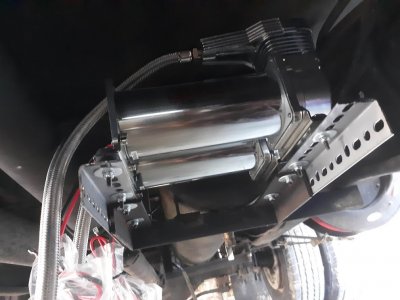

used an old oxygen bottle that was to out dated to refill for my torch as a very large air tank. upgraded from my viair 480 and 2 gallon tank to the bigger oxygen tank and two viair 485 gen 2 compressors. added a 50 foot hose reel and now have a large capacity 200 psi air system for dealing with customers trailer tires (air system is located where the oem fuel tank use to be)
went from a 4.10 gear and 33" tires down to 30" tires and a 3.55 gear... i honestly am glad to be away from that 4.10 ratio.. sounds great in theory but honestly sucked at everything besideds intown towing.
only a couple parts away from doing my 47re to spicer 3053a swap. will post more about that when its done.
old dana 80 single wheel axle with 4.10 ratio and 9 2017 18" wheels and tires are now for sale here in lumberton Tx. if anyone local wants to do a srw swap.
That is a really nice setup. I have a 5 gallon air tank and horns with air hookup, it works wonders! Great job on the dually conversion too!
thanks, i love having 200 psi and about 15 gallons of air. took 3, 11r22.5 tires from 60lbs to 120lbs quicker than my shop compressor can do... after 80psi into the tire the dual 485s can match the flow of inflation so the tank never really got below 50psi.. its very very quick and the two of them can take the tank from 100psi to 200psi in less than 2 min, thats about 15 gallon tank. its leaps and bounds better than the single 480 i upgraded from.
