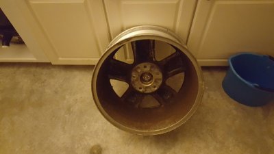

Had a good friend take off an dispose of the junk tires on the 06-08 20s I purchased a few months back. What do you guys suggest for cleaning of them? I want to clean them up before I get tires. The ones I have are the chrome clads an a couple look to have some pitting on the clad, is there anything I can use to clean up the plastic clad itself?

Mine weren't chrome clad, but I used a non-acidic wheel cleaner from Chemical Guys called Diablo Wheel Gel. That combined with a soft bristle scrub brush, my pressure washer and a little elbow grease got them looking good again. As long as it's nothing acidic, the chrome cladding should be just fine.

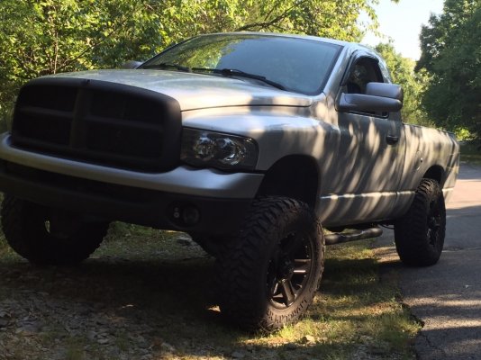

Went and took some pics at the boat ramp got a few good ones of the front end and some flexing.

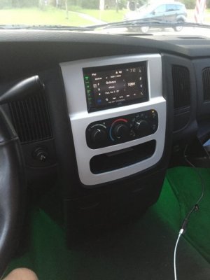

I no longer have any cigarette lighter or 12V plugs.
I replaced the upper one with a 19mm locking push button switch that will be used for my foglights and the lower one with a USB port.
I got them installed in place, I just need to get some wire to get the USB ports working. The lower 12V port is constant power and it has an LED light, so I'm going to wire it to switched power so that the battery doesn't drain down since I don't drive the truck constantly.
I had to pay a $26 ******* tax while I was working on it though. I wasn't paying attention when I was cutting some zip ties and caught my SiriusXM antenna and cut the wire in half. Ordered a new one, so it'll be here in a couple days.
