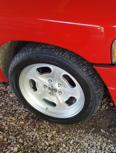

I made some wheel spacers from a set of discs I got from work. Took an angle grinder and cut off the face of the disc and cleaned them up. I installed them this evening before leaving the shop and no more rubbing :)
Between grinding a bit of the uca and the diy wheel spacers I now have 1/2 inch of clearance. Tomorrow I tackle the back. Just going to trim the inner fender until I can get spacers made for the back.

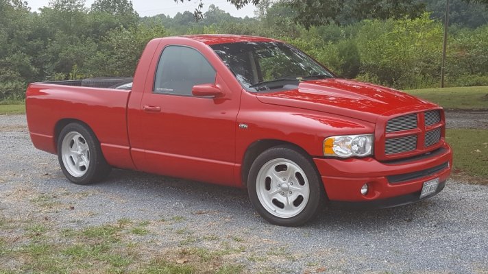

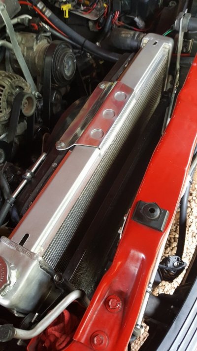

It's been a while since I've last posted and don't remember what I had finished. The latest changes have been 05 pcm swap, relocating the gas tank, billet wheels and a larger radiator.
That's 3/6 drop? what size tire?
Bigger radiator!?!?!? Where do I get one? Lol

The rear tires are 295/50-20 on a 20×10 rim. The radiator is a 69 427 camaro. I made adaptor brackets to mount the radiator to the oem mousting holes. Takes some trimming, but the end product fits nicely. The 05 manual trans pcm I'm using is a rare bird and took some effort to find. I have a stand alone trans.
