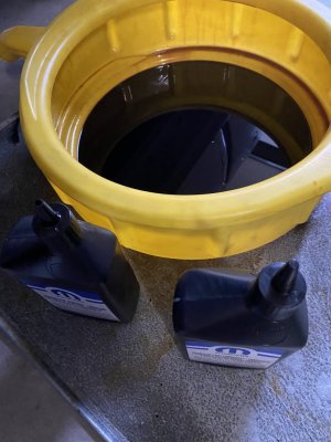

Found a rainbow and followed it to the other end where I found a leprechaun. Asked said leprechaun where to find unicorns and off I went. Finally found one, made it cry (not telling how) and carefully bottled up its tears. Brought the bottled unicorn tears home and finally changed the fluid in my tcase.
What were you smoking on this trip?
Not sure really, but it was around 4:19 when the adventure started. I was hungry and hit the drive thru, asked for a quarter pound..........thought I was at Burger King.
YEah, and pass to the right
Puff, puff, pass.........
