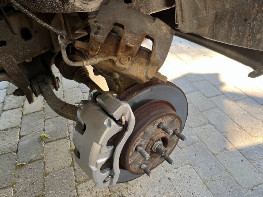

both piston ceased in Caliper, it got werry hot before I got home :D
could not move them with a biig water pump pliers with hose removed and nipple out :O

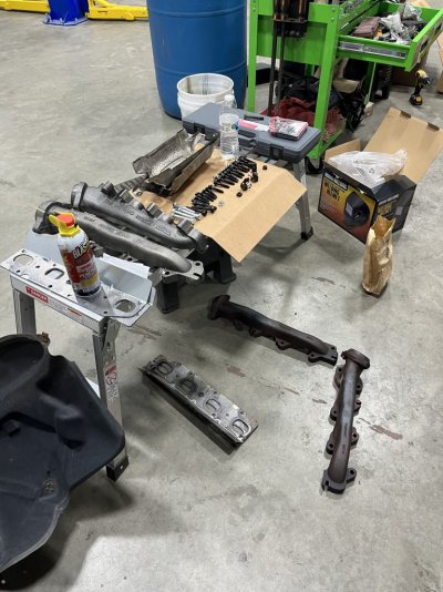

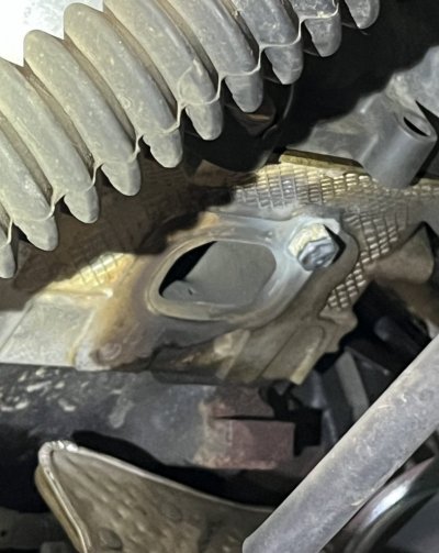

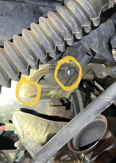

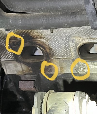

So I had enough of that infamous “Tick”. Had 5 broken manifold bolts that I removed by welding nuts to them since they were below the aluminum heads. New exhaust manifold’s, new hardware. Certainly was easy up on a buddy’s lift. TICK BEGONE!

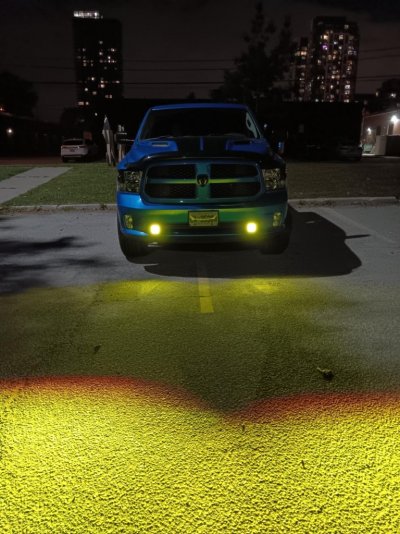

How about sharing a picture of your truck with these fancy new fog lights? :cool:

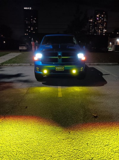

Installed my new Fahren highs/lows this weekend, too, and adjusted the headlight assemblies.
Now I just need to adjust my new fogs.
I also had XPEL protection film put on my headlight assemblies and fog as well. Keeping them crystal clear and chip free is important.
