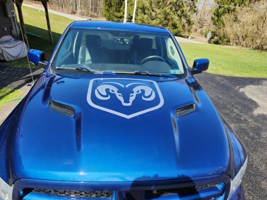

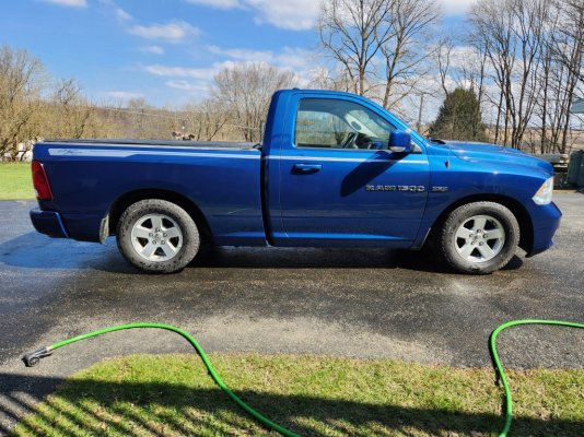

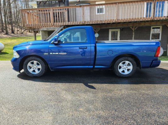

Brought it outside and washed it. Good time to show what I did with graphics. I am still going to do some pinstriping, and a couple other things.

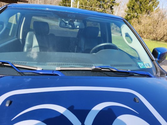

I don't know if I showed how I painted my wiper arms, so here's a pic.
It's going in for front end alignment tomorrow, so then I'll be able to drive it around.

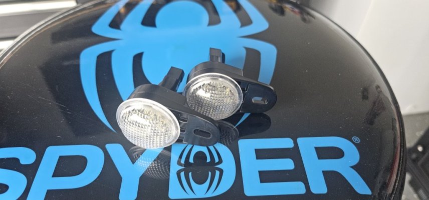

Color matched my taillights

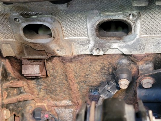

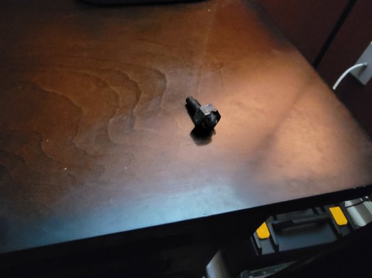

So I finally finished my manifold on passenger side (2 broken bolts, 1 was flush). Didn't do driver side yet, will do that another weekend (no leaks or broken bolts). The original broken bolt stuck out a bit so I got a stud extractor bit and got that pretty easy. The other broken bolt snapped as soon as I started breaking bolts free. It was just under the broken bolt so it was blasted with exhaust glasses for months. I tried drilling and using easy outs,but couldn't get it and then had my son in law bring over his flux core welder. Took a few tries to get it hot enough. Attempt that worked wasn't even centered on the nut and still backed out easily. The last pic is the one that shows the drilled out bolt. The back left 2 bolts are the ones that broke. Seems to always be those 2, probably the hottest part of the manifold. Just glad I got my BD diesel manifold on there and no more tick.

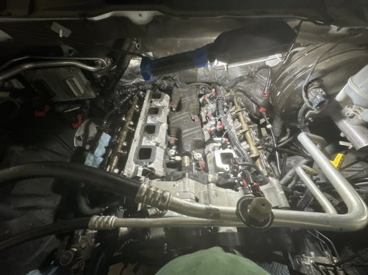

That reminds me I got to do coils and plugs on my 3.6....which means spend half a day taking the upper intake off for 45min of coil and plug replacement lol
Would like know how it goes. Got to do mine soon and have never attempted on this 3.6L
