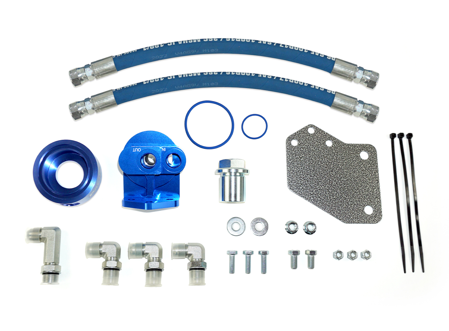

There's a plethora of variations of oil filter relocation setups available. Some are a direct bolt in, some are "universal" and require some knowledge to make your own (cut to fit) hoses.
I went to direct bolt it route with a PacBrake relocation kit. Makes oil changes completely mess free. I run the larger Mopar 899 filter so I go an even 8 quarts on oil changes now.

Nice, I have had this on my mind for some years now :D I have the end parts from summit anodized black, I just need to get houses crimped...

Looks like a nice clean set up. I'll probably go this route next time.
Thanks for the link.
