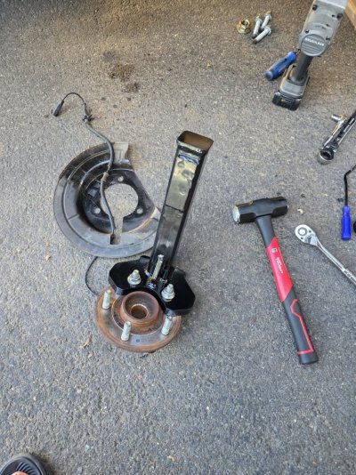

Got a head start on replacing my hubs after work yesterday since I have to help the wife go watch the grandkids and dogs so my daughter and son in-law can go to the Navy khaki ball.
The hub shocker tool worked amazingly. That's only a 4lb mini sledge and I didn't wail on it. Was stuck on there pretty good too since I live in PA and truck is 8 years old with 76,000 miles. Got to finish putting driver side together and then knock out passenger side. Took me a while to sweep hickory nuts off my driveway and get the truck set up on jackstands or I might have finished last night. Also doesn't help that it gets dark by 7 and I didn't get started with everything till 5pm.

Finished up the driver side and passenger side yesterday morning. Went really smooth with the hub buster tool. The hubs were rust jacketed pretty bad. Pic is right before I knocked it off. Didn't have to resort to my big sledge either. The 4lb mini sledge knocked it off in 6 or less whacks. Still hear a weird sound with slight vibration on full lock right turns, but truck is much smoother now. I'm thinking although the rotor and pads look fine that they're the culprit now. Sound goes away when braking and cv axles and hubs are new. Definitely not a ball joint or tie rod sound. I didn't put the rotors on, I was out of work following my back surgery 2 years or so ago and had the shop do it to pass inspection. For now I'm waving the white flag. Almost all suspension components are new and brakes work fine so not concerned it's a safety issue. 1000003312.jpg
