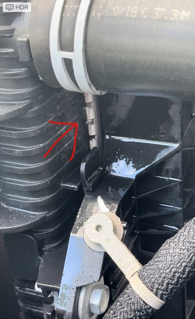

Coolant is coming out of the side of the radiator on the drivers side. Not sure what is happening. It was overfilled quite a bit not sure if that’s the case. Have any of you had the same problem.

If it's coming out of where the red arrow is you need to replace the radiator. Tank is leaking. Not an uncommon failure when it comes to plastic tank radiators. But I don't recall seeing that in a RAM before.

Shoot alright, just bought the truck last week. Thank you!
Sorry to hear that!
Good news is that it's a pretty easy radiator to replace compared to other cars and trucks I have done in the past.
