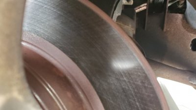

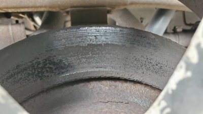

Rear Driver & Passenger *old* rotor wear
